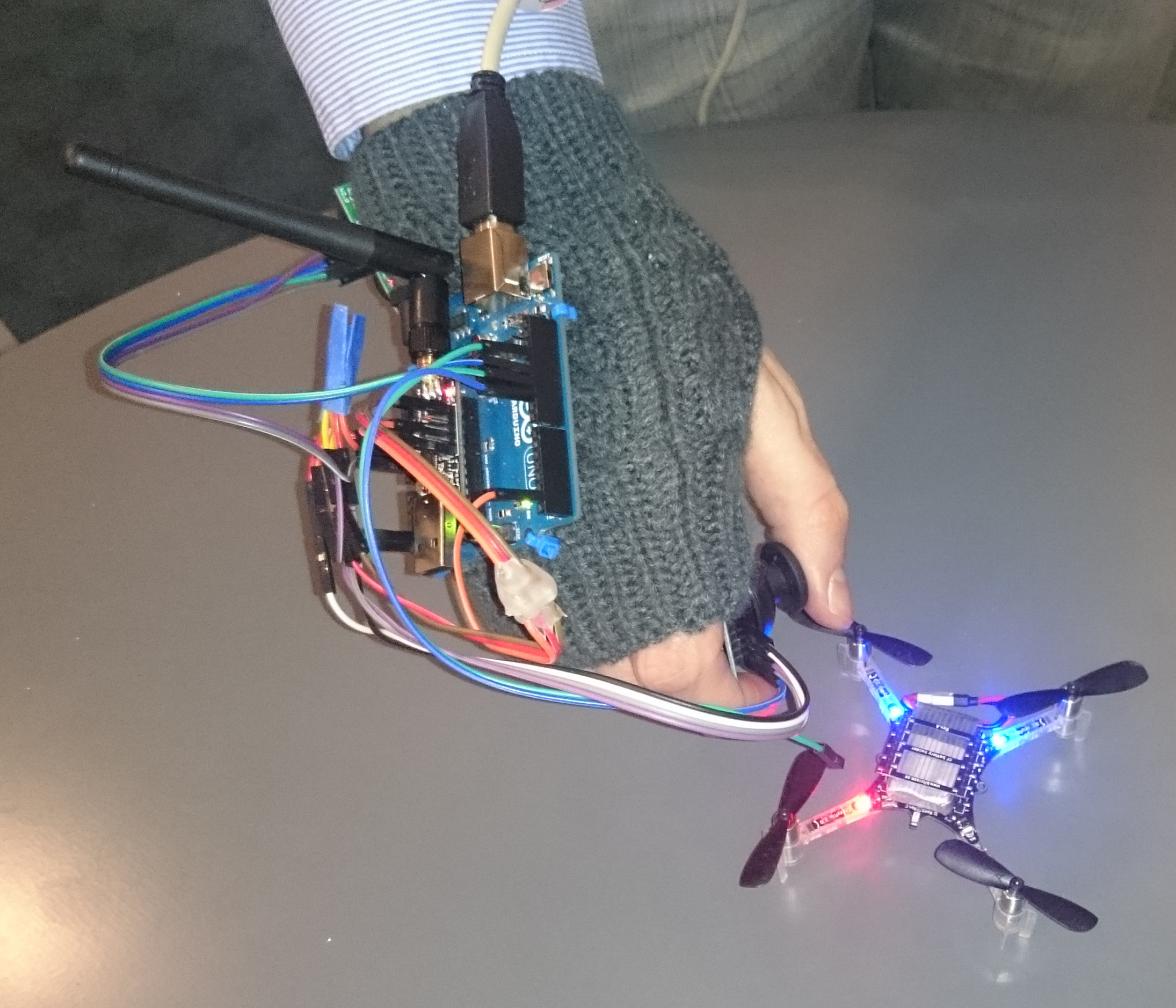

We have always been interested in controlling Crazyflie with various devices. For example we had the Leap Motion that enabled us to control the Crazyflie with our bare hand. Then we hacked a glove for Arduino day. At Maker faire Berlin 2016 we met the team from Specktr. Specktr is a midi glove and since our demo was controlled with midi we had to try connecting the Specktr with Crazyfile 2.0 flying using Loco Positioning System!
We met in the evening, after the faire was closed, and started hacking to map the midi messages transmitted by the glove to our midi to position ROS node. After a couple of mandatory crashes and crazy behavior (like setting the flight area way too big and sending the Crazyflie high speed away at the snap of a finger, too bad we have no video of that …) we had things working well and the glove could control the Crazyflie X position:
The second and last day of the faire we did a more proper connection where both X and Y could be controlled. The result is quite nice. It looks near magic, and quite fun, to control Crazyflie just by just moving the hand:
