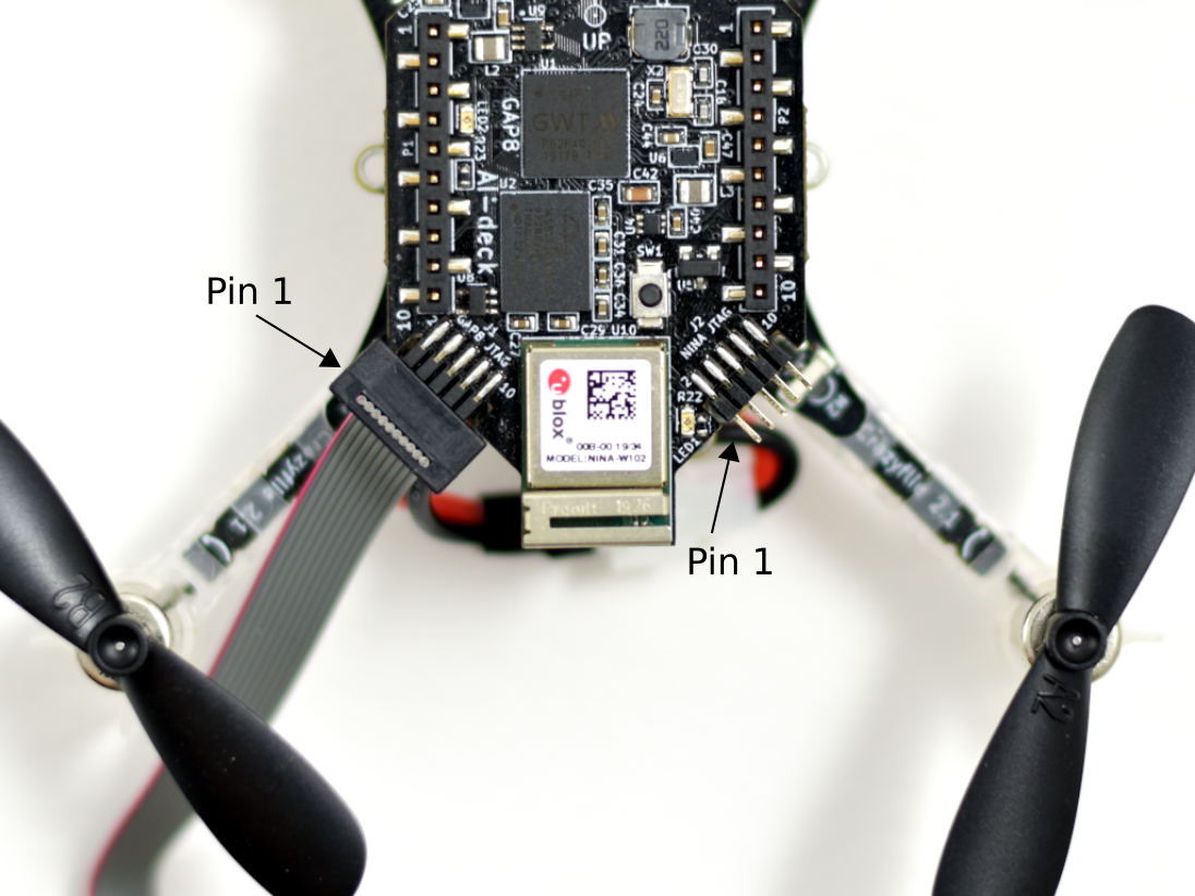

JTAG
You can flash the example with an Olimex ARM-USB-TINY-H JTAG using the following command (replacing example-directory with the example you want to flash):
docker run --rm -v ${PWD}:/module --device /dev/ttyUSB0 --privileged -P bitcraze/aideck tools/build/make-example [example-directory] flash
Note: This will overwrite the bootloader!
Note: USB in docker is only supported on Linux
jtag lint cable connection
