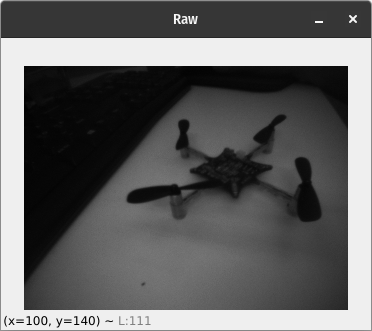

Then you should be able to see the raw/color or jpeg image in the viewer like this:
opencv viewer
