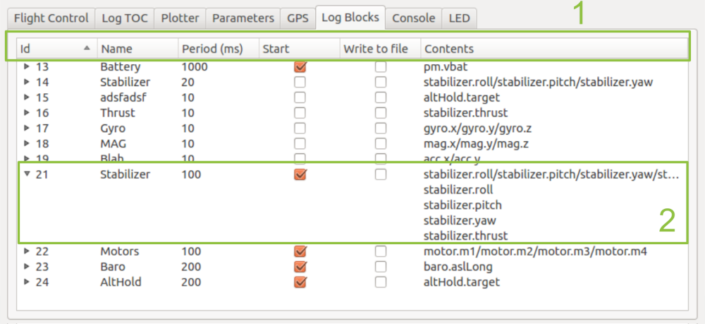

The log blocks tab shows all log configurations that are saved and if they are started. It's also possible to start/stop them as well as write the logged data to file.
- Fields
- ID: Block id in Crazyflie
- Name: Block name in client
- Period: The period of which the data is sent back to the client
- Start: Marked if started, click to start/stop block. Note that some of the blocks are used for the user interface, so if they are stopped the user interface will stop updating
- Write to <file:> Marked if writing to file, clock to start/stop writing. The data will be written in the configuration folder for the client (see <here> how to find it).
- Contents: The variables contained in the block (named by group.name)
- Information for log configurations are folded by group by default, opening them up will show in detail what variables are in the group
