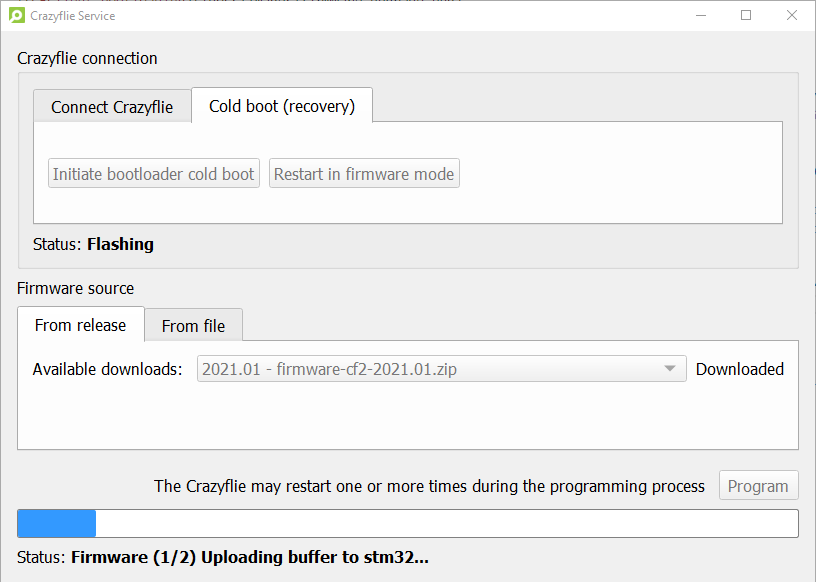

For updating the Crazyflie firmware there's the possibility to enter bootloader mode and flash new firmware from within the client. The bootloader mode is accessed from the menu Crazyflie->Bootloader. If there is any problem during the flashing or a wrong firmware is flashed the process can just be started again.
To update the firmware in the Crazyflie 2.X do the following:
- Make sure that the Crazyflie is disconnected from the client and powered off.
- Go to the menu Crazyflie->Bootloader
- Select the "Cold boot (recovery)" tab in the dialog.
- Press and hold the power button on the Crazyflie for about 3 seconds. The blue LED (M2) starts to blink to indicate the Crazyflie is in bootloader mode. If a wrong nRF51 firmware has been flashed you might have to start from an un-powered state. Then hold the button and connect power.
- Click "Initiate bootloader cold boot" in the client
- Select the latest release from the drop down menu or the file if you have downloaded it from the Github release page.
- Press "Program" and wait (do not restart the crazyflie until it is finished.)
- Press "Restart in firmware mode"
