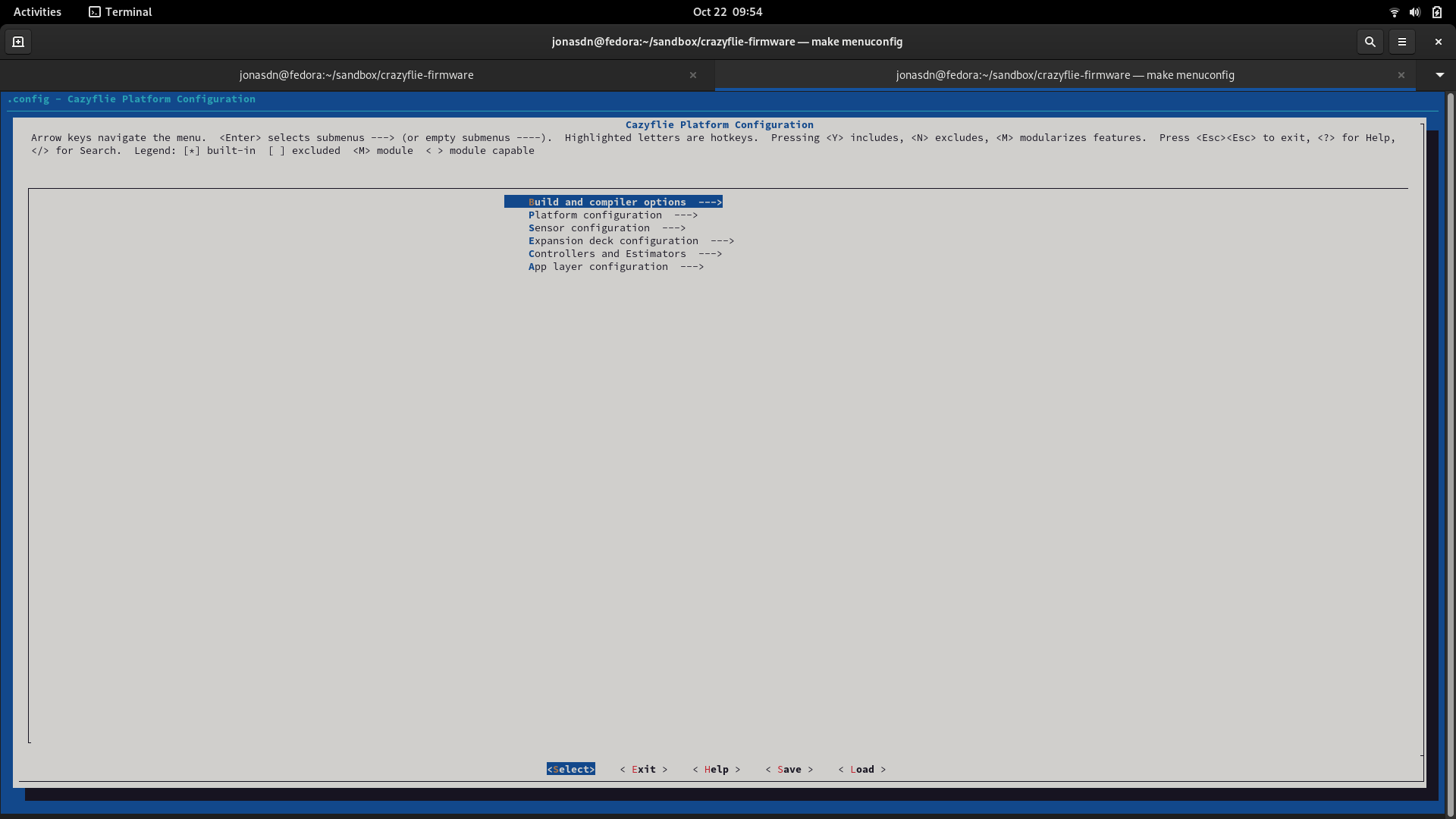

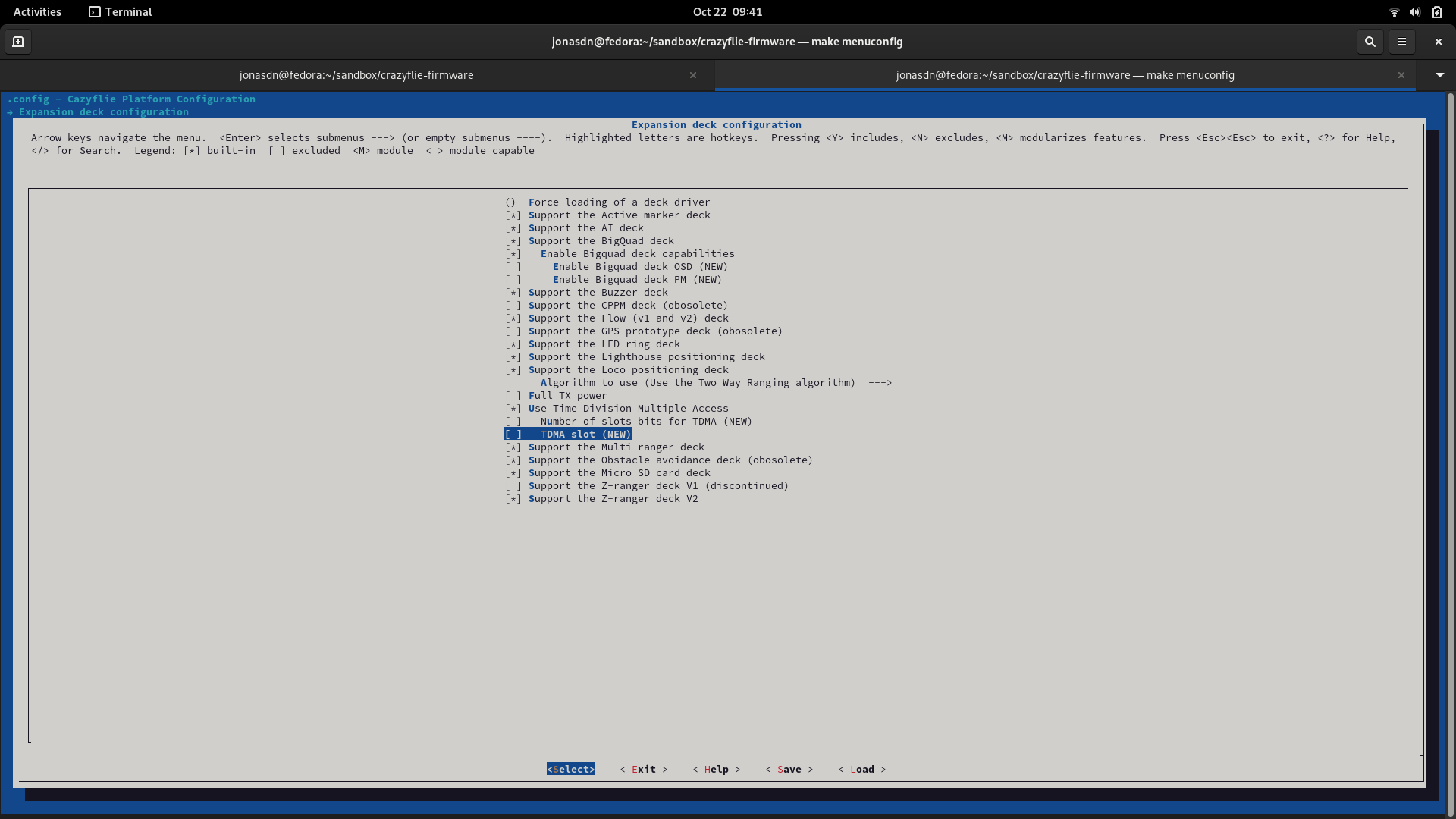

If you want to customize your build you can use the menuconfig by typing:
$ make menuconfig
This will drop you into a terminal based user interface where you can configure and customize what will be included in the firmware. To use this you need to have some extra packages installed on your system, the equivelent of the following Ubuntu packages:
$ sudo apt install build-essential libncurses5-dev
To get an idea of how menuconfig will look, please see the images below.
Main menu of menuconfig
Configuring deck drivers
