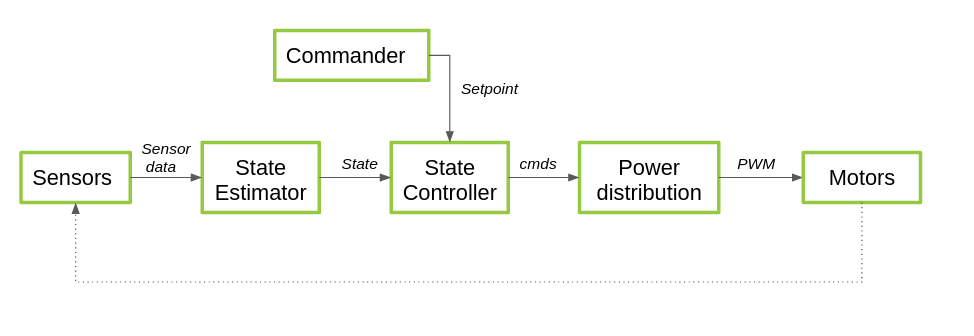

This page is meant as an introduction and overview of the path from sensor acquisition to motor control,also called the stabilizer module. It will not go into detail but it mostly give a general outline of how the sensor measurements go to the state estimators to the controllers and finally distributed to the motors by power distribution. Of course, the motors have an affect on how the Crazyflie flies and that indirectly has an effect on what the sensors detect in the next time step.

Overview
Modules
