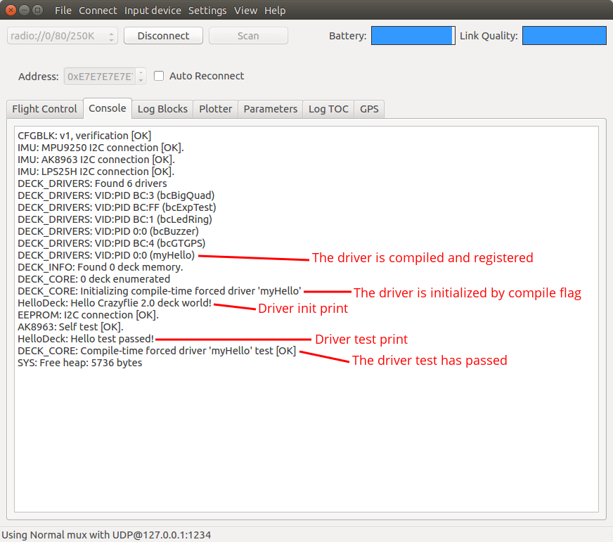

Now you can connect your Crazyflie with the client and see your driver in the console!
deck hello console
