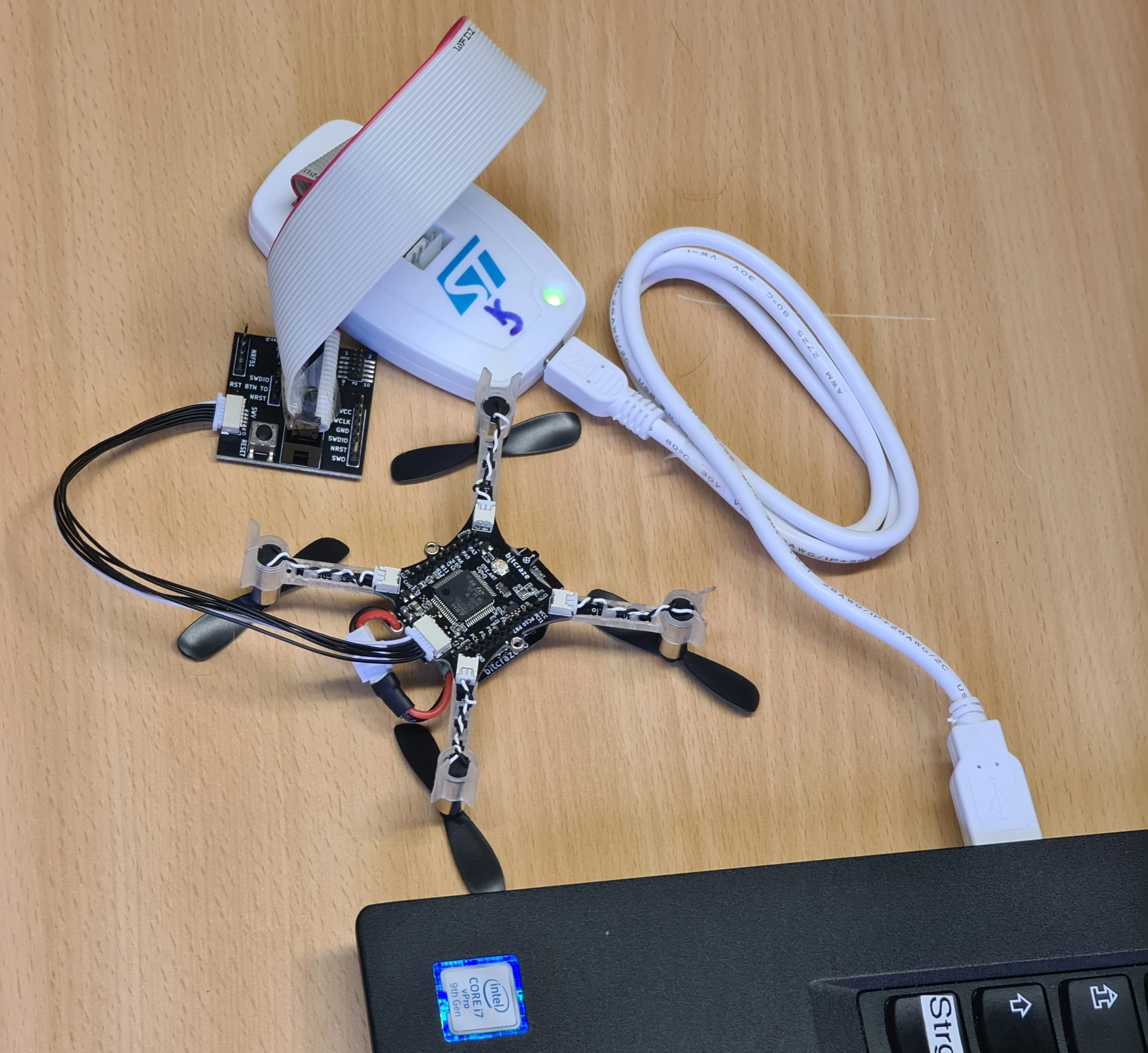

Connect the the Crazyflie to your ST-Link V2 via the Debug Adapter and the port on the underside. You don’t need to solder the second adapter to the drone if you’re only planning on debugging the STM32F405 with the crazyflie-firmware.

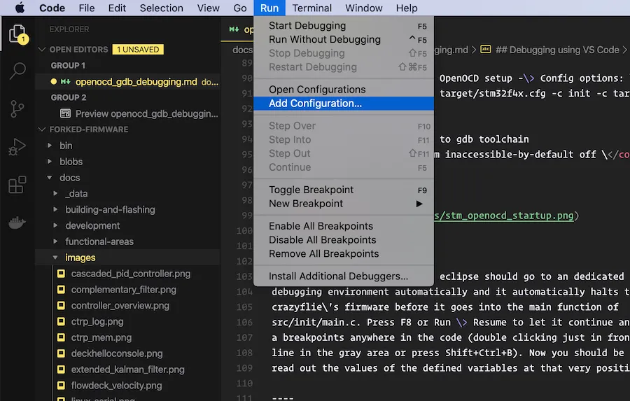

Install the extension either by clicking “Install” on the web page, or by searching “Cortex Debug” in the Extensions tab of VS Code.
Click on “Run”, then “Add Configuration”, then “Cortex Debug”.
VS Code add configuration
This should automatically create the needed “launch.json” file.

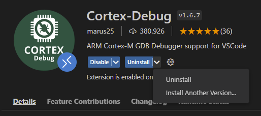

The version of cortex-debug tested here is 1.2.2
Unfortunately it is possible that newer versions of this Extension won’t work with our current setup, so please downgrade to 1.2.2 . You can do that by going to ‘uninstall’ and ‘install other versions…’.
Install other Versions of Extension
It should also be noted that VSCode updates Extensions automatically, sometimes even if you manually downgraded to a legacy version. If you don’t want that to happen, make sure you have checked the setting Ignore Updates in the dropdown menu of Update to vX.X.X.

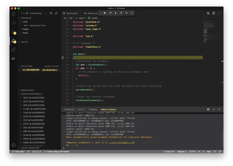

Debug!
After setup, go to the ‘Run and Debug’ tab of VS Code (on the left sidebar, the icon with the little bug next to the play button), select the chip you want to debug from the drop-down menu at the top of the pane, and hit the play button!
NOTE: Make sure your executable (cf2.elf) is identical to the one running on your Crazyflie.
If you followed everything, it should start running nicely and look a little something like the image below. Notice the nice peripherals pane at the bottom, along with the variables pane at the top. Awesome, now you can code and debug all within VS Code!
VS Code Cortex Debug

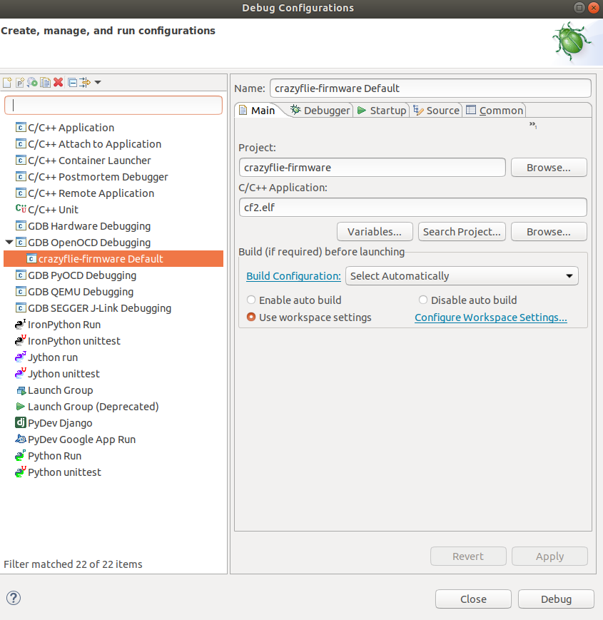

Setting up Eclipse Debugging environment
  • Go to: Run > Debug Configurations...
  • Double click 'GDB OpenOCD Debugging'
Now input the following settings in the debug configurations:
Main
stm openocd main
Insert the filepath to the cf2.elf file to C/C++ Application.

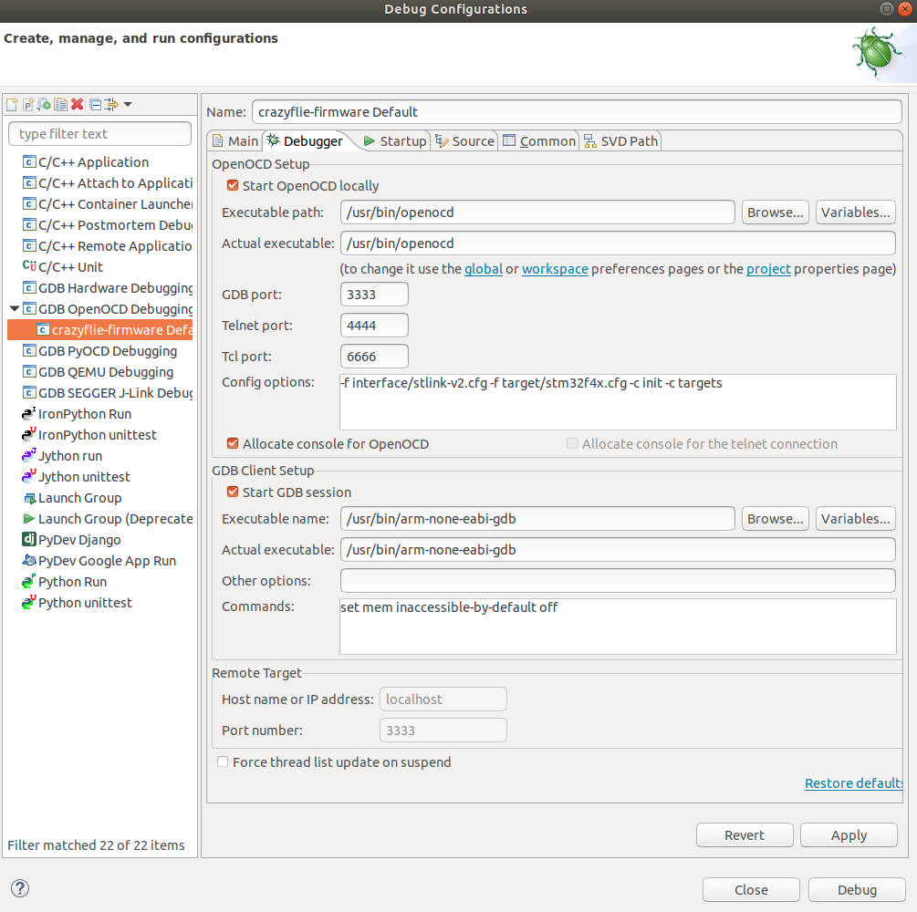

Debugger
stm openocd debug
check the following settings: OpenOCD setup -> Config options: <code> -f interface/stlink-v2.cfg -f target/stm32f4x.cfg -c init -c targets </code> GDB Client Setup:
  • Executable name: Filepath to gdb toolchain
  • Commands: <code> set mem inaccessible-by-default off </code>

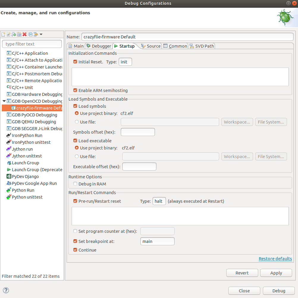

Startup
stm openocd startup
Debug!
If you don't see any errors, Eclipse should go to an dedicated debugging environment automatically and it automatically halts the crazyflie's firmware before it goes into the main function of src/init/main.c. Press F8 or Run > Resume to let it continue and place a breakpoints anywhere in the code (double clicking just in front of the line in the gray area or press Shift+Ctrl+B). Now you should be able to read out the values of the defined variables at that very position.
