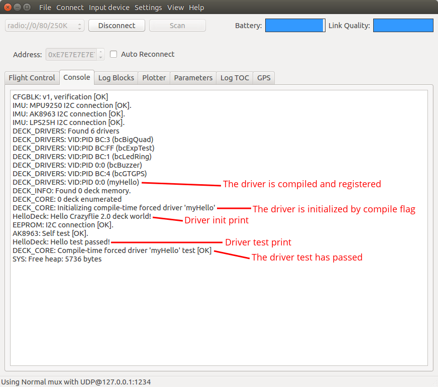

Flashing 1 of 1 to stm32 (fw): 161867 bytes (159 pages) ..........10..........10..........10..........10..........10..........10..........10..........10..........10..........10..........10..........10..........10..........10..........10.........9
Reset in firmware mode ...
Now you can connect your Crazyflie with the client and see your driver in the console!
deck hello console
