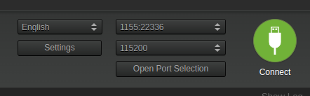

Connect the Crazyflie 2.1 Brushless using the provided USB cable. Select a serial port in the GUI. If you are working on a Linux OS you might need to add USB permissions like this: USB permissions
The serial port should be named something along the lines of “CrazyflieXX”
Connect to the pass through interface via USB by pressing the Connect button.

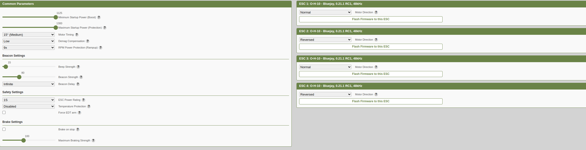

Click the “Read Settings” button. The settings read from the ESCs will now be displayed.
Be aware that setting other settings than the recommended is done at you own risk, make sure you know what you are doing before attempting to change these.
The default setting configuration we have written to the ESCs at production are;
for our default settings.
To write the setting to the ESCs press the “Write settings” button. This will write all the settings shown in the GUI to the ESCs.
NOTE if you push “reset to default” these settigns are not our default settings, but the ones specified by the esc-configurator website.
