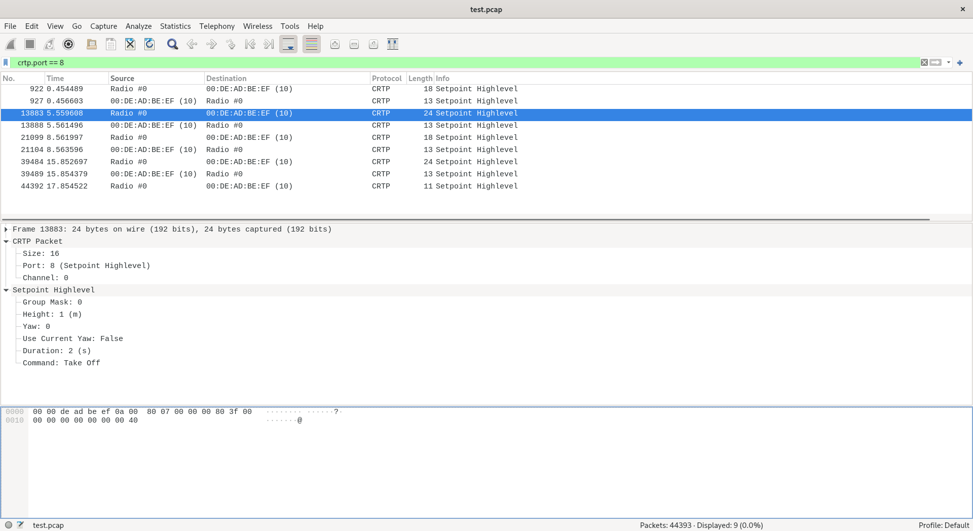

To generate a PCAP file and open it with Wireshark. You can also use the text based tshark
tool, and you can add a filter, for instance, only shoow CRTP port 8 (Highlevel setpoint):
$ tshark -r test.pcap "crtp.port == 8"
6 0.003333 00:DE:AD:BE:EF (10) → Radio #0 CRTP 13 Setpoint Highlevel
13158 5.176752 Radio #0 → 00:DE:AD:BE:EF (10) CRTP 24 Setpoint Highlevel
13163 5.178626 00:DE:AD:BE:EF (10) → Radio #0 CRTP 13 Setpoint Highlevel
17768 8.179085 Radio #0 → 00:DE:AD:BE:EF (10) CRTP 32 Setpoint Highlevel
17773 8.181294 00:DE:AD:BE:EF (10) → Radio #0 CRTP 13 Setpoint Highlevel
21223 10.181543 Radio #0 → 00:DE:AD:BE:EF (10) CRTP 32 Setpoint Highlevel
21228 10.183293 00:DE:AD:BE:EF (10) → Radio #0 CRTP 13 Setpoint Highlevel
24030 12.182588 Radio #0 → 00:DE:AD:BE:EF (10) CRTP 32 Setpoint Highlevel
24035 12.185723 00:DE:AD:BE:EF (10) → Radio #0 CRTP 13 Setpoint Highlevel
26449 14.184183 Radio #0 → 00:DE:AD:BE:EF (10) CRTP 32 Setpoint Highlevel
26454 14.185862 00:DE:AD:BE:EF (10) → Radio #0 CRTP 13 Setpoint Highlevel
28388 16.187258 Radio #0 → 00:DE:AD:BE:EF (10) CRTP 24 Setpoint Highlevel
28393 16.188963 00:DE:AD:BE:EF (10) → Radio #0 CRTP 13 Setpoint Highlevel
30533 18.190823 Radio #0 → 00:DE:AD:BE:EF (10) CRTP 11 Setpoint Highlevel
