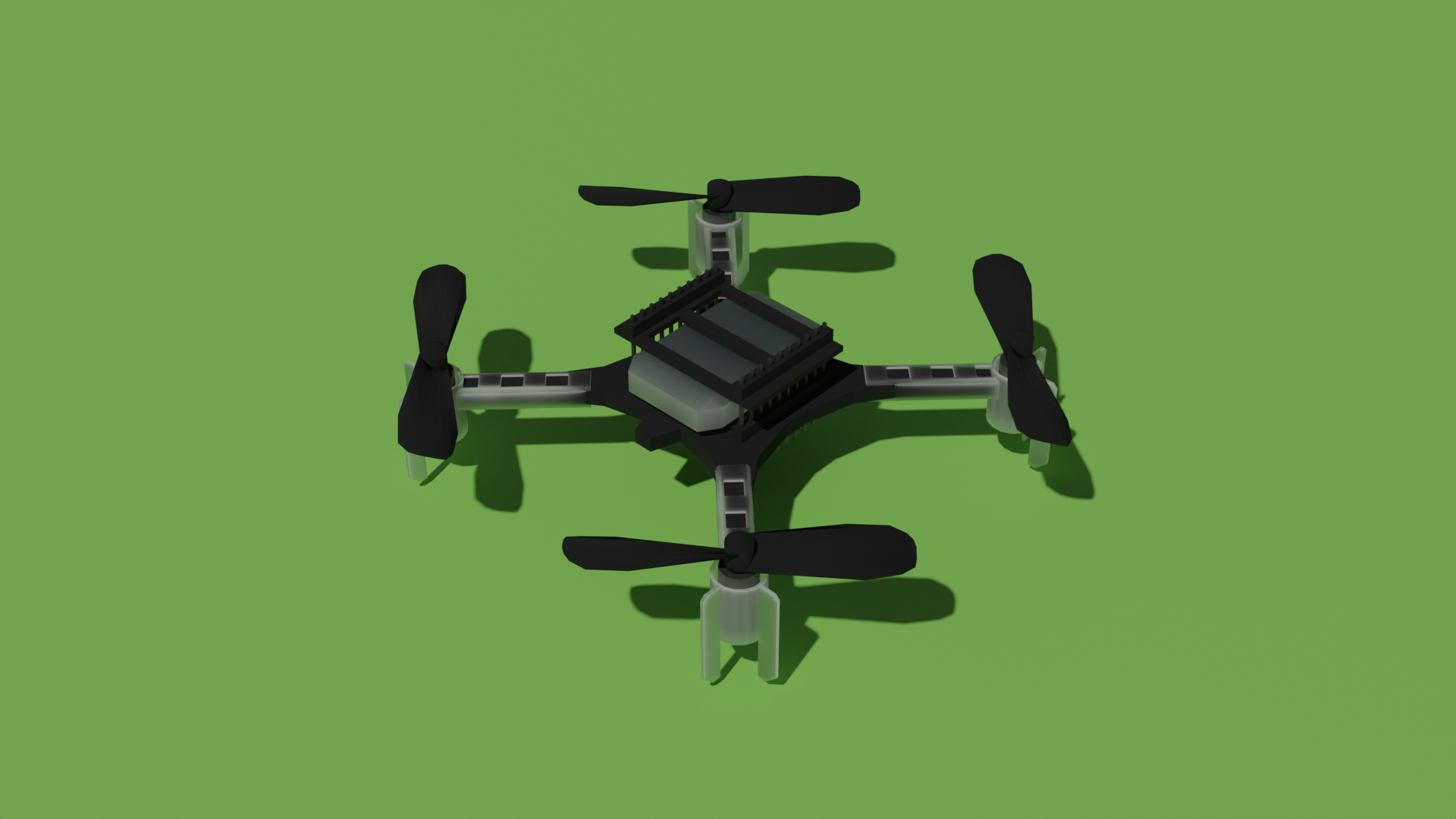

So the mesh files assembled looks a bit like this as a render in blender:
crazyflie render
Measurements Crazyflie Assembly
If you’d like to use the mesh files to assemble a full crazyflie, these are the location the individual parts in meters:
  • Propeller origin from center (0.031, 0.031, 0.022) m
    • Mirrored in the x and y axis
  • Motor mount + motor mounts (0.031, 0.031, 0.014) m
  • Body origin height from center ( 0, 0, 0.015) m
  • Battery holder height ( 0, 0,0.025) m
  • Battery height (0,0,0.02) m
  • Pin headers (0, 0.011, 0.014) m
    • Mirrored in the y axis
