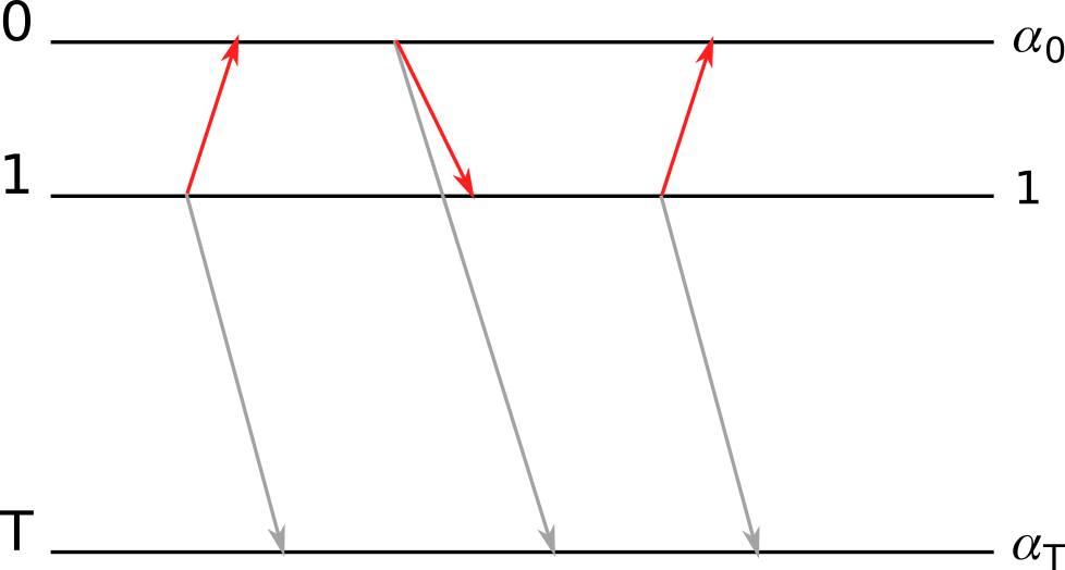

If we consider the 3 last packets sent from anchor 0 and 1:
TDOA packet

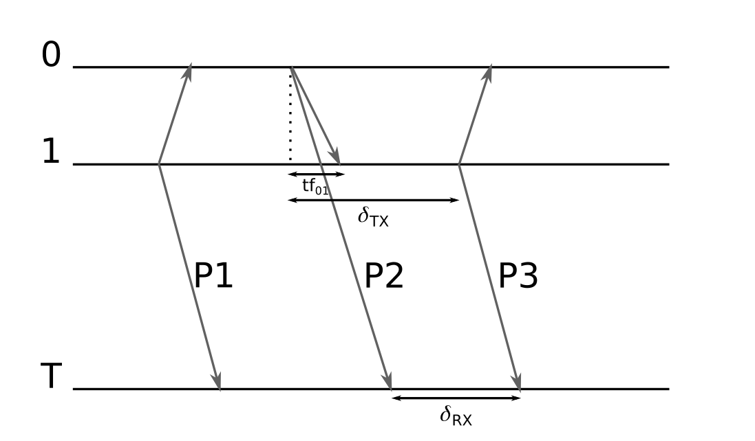

We can calculate the difference of time of flight (which is the difference of time of arrival, TDoA) by calculating the difference between δtx and δrx. From the tag's side this can be done by receiving the last packet from each anchor: TDOA to tag
δrx is measured when receiving the two packets. δtx can be calculated in the anchor 1 clock if we know the time it takes to fly from 0 to 1: Anchor 1 measures the time of arrival of the packet P2 and so knowing the time it took the packet to arrive to 1, we can calculate when it was sent by 0.

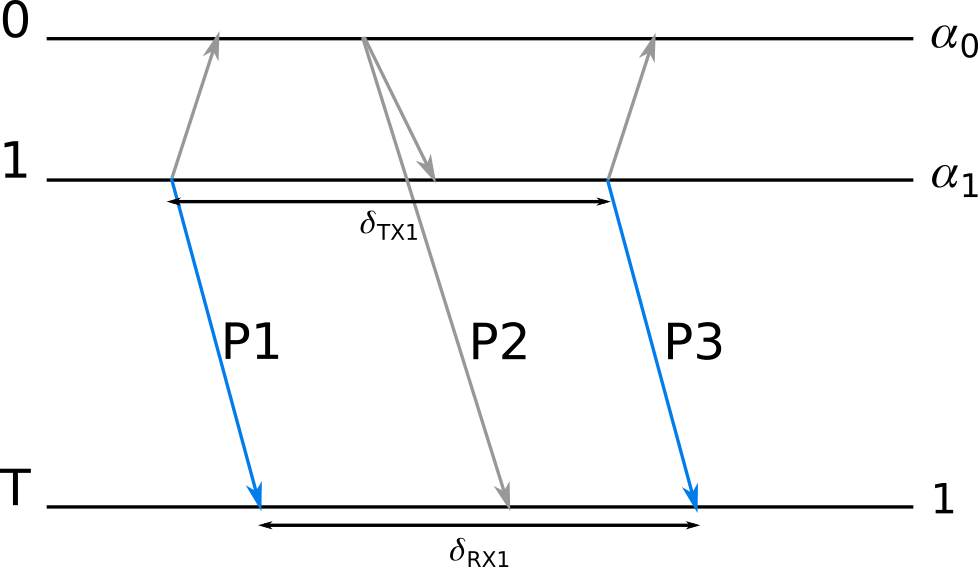

The time of flight between 0 and 1 is measured by the anchors and transmitted in the packets. It is measured using two way ranging: TDOA anchors

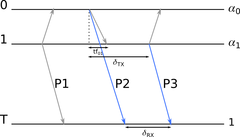

Once we know the transmit time of P2 in the anchor 1, we can calculate δtx and δrx. Though δtx is expressed in the Anchor 1 clock. Each node have an imperfect clock and we need to compensate for drift between the clocks. To do so the tag uses two consecutive packet from Anchor 1 to keep track of the clock drift coefficient between its own clock and Anchor 1 clock: TDOA measure drift
Using these two packets we can calculate α₁ = δrx1 / δtx1. We can now calculate TDoA = δrx - (α₁ * δtx).

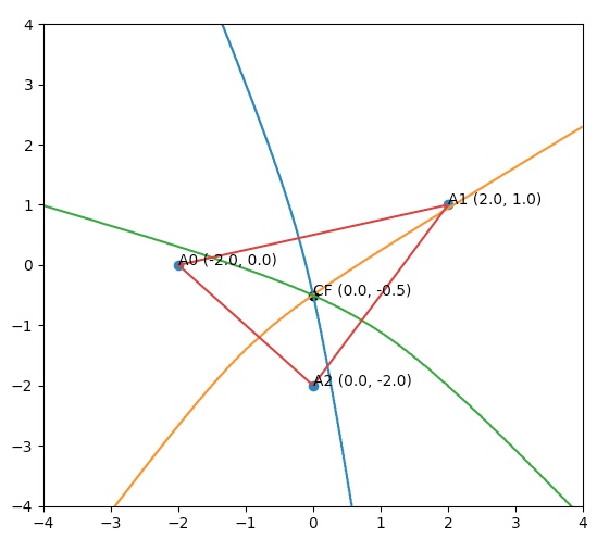

Consider an example set up where we have three anchors, A0, A1 and A2. This example is in 2D to make it easier to visualize, but the same principles are valid for 3D.
In the first image the Crazyflie (Tag) is located at (0.0, -0.5). The lines where the TDoA is constant are drawn in the figure and the position is where the lines cross. For instance, the TDoA between anchors A0 and A1 is 0.44 (a bit closer to A0 than A1), this means that the Tag could be anywhere on the blue line. The yellow line shows possible positions based on the TDoA value between A0 and A2, while the green line is for TDoA between A1 and A2.
In convex hull

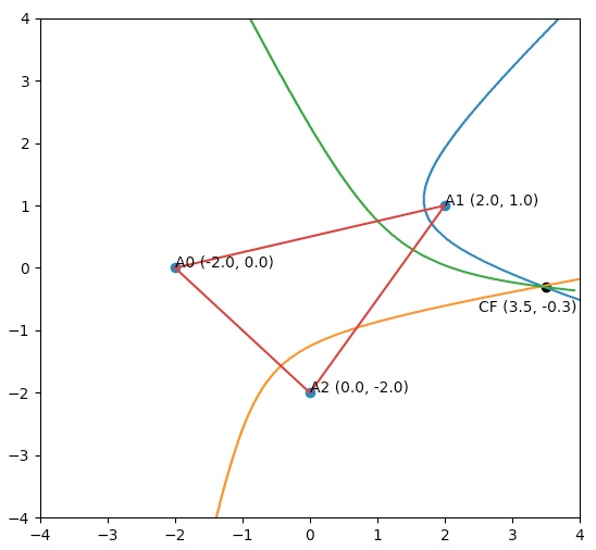

In the second image the Tag is further away, at (3.5, -0.3). Note how the lines showing the possible positions are close to parallel in the intersection point, making it harder to estimate a correct possition.
Outside convex
The red lines shows the convex hull of the system, basically the space defined by the anchors. A good rule of thumb is that the accuracy of the estimated position is good withing the convex hull but deteriorates quickly when moving away outside.
