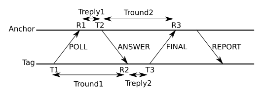

The two way ranging protocol allows a tag to measure its distance to an anchor. The protocol contains 4 messages, two are sent by the tag and two by the anchor. The message sequence is as follow: TOA
The time of flight is calculated using the formula: Formula TOA
