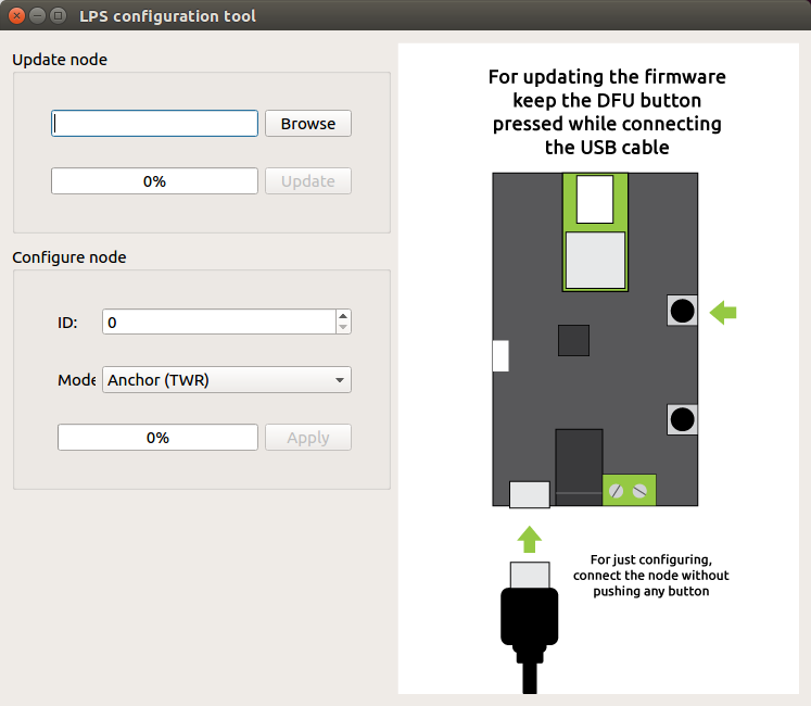

The LPS configuration tool is used for configuring the Loco Node via USB. It's used for:
- Firmware update
- Positioning mode
- Address configuration
To use the LPS tool start the program and follow the step by step instructions.
